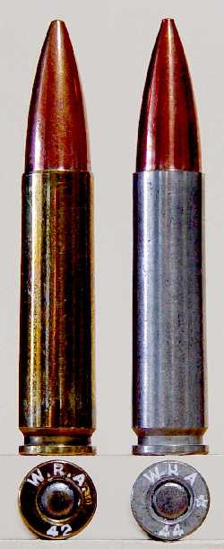

Same subject but a different question.
I have both the plain brass cased and the tin plated WRA 43. But, the plain one is 1.983" OAL while the tin plated one is 2.119" OAL. Both magnetic bullets. So what's the deal? Different bullets or just different seating depth?
I've been wondering about this for years. Somebody ease my mind so I can wonder about more important things.

Sun Mar 09, 2008 2:29 pm
Ray
The five Military rounds (4 GMCS and 1 GM) I have handy measure between 1.981 to 1.995".
In the 1960's a Company in Southern California (National Ordnance I think but I can't find my notes on the subject) loaded a quantity of Hight Pressure Test catridges using military cases to test the M1 Carbines they were puting together. They measure from 2.127 to 2.137". You can see the seating cannelure at the neck but none are tinned. So I really don't know. Here are a couple examples.

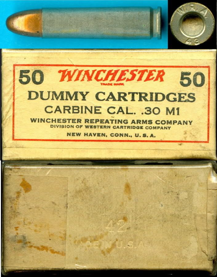

I have a similar box as Guy's except it is for dummies that does have military headstamped cases.

Phil - with respect, that box really isn't that much like Guy's proof box. Firstly, it has the military designation of the cartridge. It is the first model of standardized dummy rounds, M1, and was made from late 1941 until December 1943. It was used primarily for inspection of arms, and not for drill purposes. Secondly, it does not use what I call "commercial language."

I believe John is correct about my box being a commercial box. I have the same dummy box with the military headstamps as PButler. I imagine Winchester did what they could to get rid of stocks of all the military cartridges they still had on hand when the war ended. Has anyone seen other caliber (.45 ACP and .30-06?) dummies or ball loads that have military headstamps in commercial boxes?

You may be correct. There was a

Phil,
Both of my boxes have that same big 42 on the bottom. Perhaps Winchester over-estimated the number of boxes thay would need in their 1942 box order. I suspect it would be possible to find some of their post-war sporting .30 Carbine cartridges in this same box.

Phil,
I forgot to mention that my box came full of PC 43 headstamped ball cartridges, obviously not original to the box.
