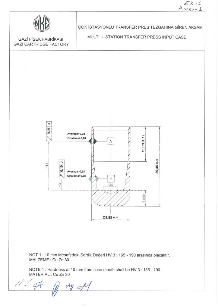

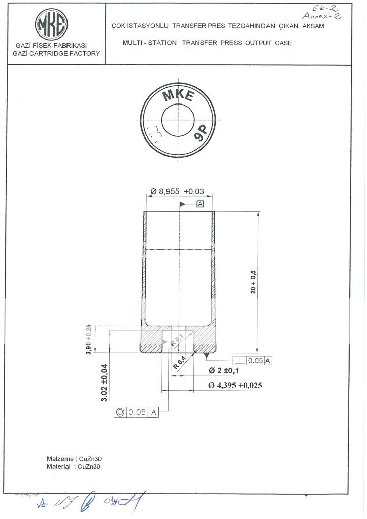

Technical Specification for the procurement of multi-station transfer press for the production of pistol cartridge case (2011):
1 - Deep drawn 9x19mm pistol cartridge case cup technical drawing (input material):
2 - 9x19mm pistol cartridge technical drawing (output material):

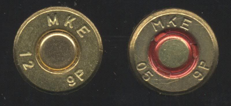

MKE 12 9P

Thanks a lot for the drawings, showing stadia of current production methods, as far as I can tell.

Hooke,
Thanks for the headstamp drawing-and thanks to johnnyc for the box label.
Hooke, your headstamp is very interesting because I think it was made by a very different company than the 2013 headstamp illustrated below which is from johnnyc's box. Notice the difference in the "K", the "E" and the "9". The spacing of the letters is also very different.
I think the 2013 headstamp looks like it was made by MFS (RUAG Hungary).
The "K" on the "12" round Hooke pictures is really different than any that come to my mind. Does anyone have any idea whose it is???
Since the MKE request for bids was dated April 2011, I'd be surprised if they got the contract awarded in less than a year so production deliveries were likely in 2013, but perhaps in 2012.
Either the 2012 headstamp was from a previous contract, or perhaps MKE awarded a contract to more than one bidder and both cases were deliveries against this contract.
I suspect the second alternative is correct since I have an MKE 05 with a red pa which is confirmed to be made by MFS, and a MKE 12 which has the same basic letter style as the MKE 05 and MKE 13 (except the "M" is very different). All three of these rounds have the same brass bullet!
There is another alternative. The primer crimps between Hooke's 2012 headstamp and both my 2013 hst and the 2005. The 2005 I have was reported to be completely loaded by MFS for MKE. Perhaps this is true and my 2013 load was also loaded by MFS for MKE while Hooke's 2012 was loaded by MKE (with the smaller primer crimps) from the cases supplied on the 2011 contract!
Other thoughts appreciated!

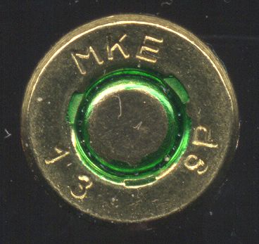

MKE 11 9P

Post Re: Turkish MKE 9 mm Parabellum Specifications
Hooke, Well done! I think the primer crimp is in fact Turkish! When I looked, I found I had 7 Turkish specimens with the square primer crimps like your 2012 dated case. I should have thought of looking at them. Only excuse is that until a couple of hours ago I had two Germans returning from SLICS staying with me.
Much appreciate your postings and research!

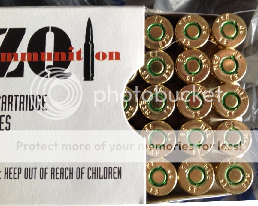

Well, another curve ball. I just received a box of the MKE 13 rounds and it is different from anything pictured above!!!
Note the letter style and primer crimp is like that pictured by Hooke on his MKE 13 and the photo immediately above, BUT the date is on the left of the headstamp instead of the right. This is now three headstamp variations among this stuff.
Both of these boxes came out of the same Walmart store as far as I know!
Has anyone found rounds maked like the MKE 13 in Hooke's picture immediately above??? If so, save one for me!!!
Has anyone found any other headstamp styles from the Turkish 9mm ammo from Walmart. If you see any, pick up a few boxes cause there are a number of us that would like some!
Fede, A friend of ours who bought the first two boxes also bought one for John M and it was full of the ones like those in your illustration!!!
This is a crazy world for a headstamp collector...
Thanks for your post.
