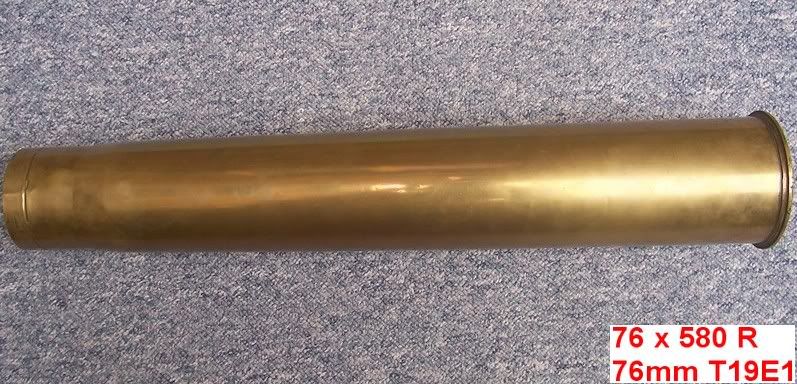

I hope this comes out readable. I would highlight the headstamp with white but some of the paint markings go over the stampings, and I don't want to mess them up. Sorry for the delay in posting these.
[img]http://i568.photobucket.com/albums/ss121/cartguy/100_3858.jpg[/IMG[IMG]http://i568.photobucket.com/albums/ss121/cartguy/Skyswep75.jpg[/img]

Cartguy,
Thanks very much for sharing these pictures. The headstamp is in best quality so you did great! I have no idea on the meaning of the yellow paint markings. Anybody can help? The faint white painting ends with 2.This could be the last of: CTG T50E2 ,but thats just a thought.
Mon May 28, 2012 4:24 am
Joined: Sun Sep 27, 2009 10:42 am
Posts: 55
Post Re: 76mm rounds?
SteveF wrote:
On the middle case once again no ink, here is what I can read so far. 119E1B1 LOT NOR-1 1953
I will try and clean this up some more
Steve
Steve you proved me wrong on this one. Check the first number 1 ,this should be te T . 76mm T19E1B1 You can find the same case with 76mm M88B1.The Guns are Cannons M32 and M48. They are high-velocity tank and antitank weapons. The cases measurments are much like the 3 inch MKIIM2 thats where I went wrong. I have a reworked case wich is 3 inch transformed to 76mm T19E1.
