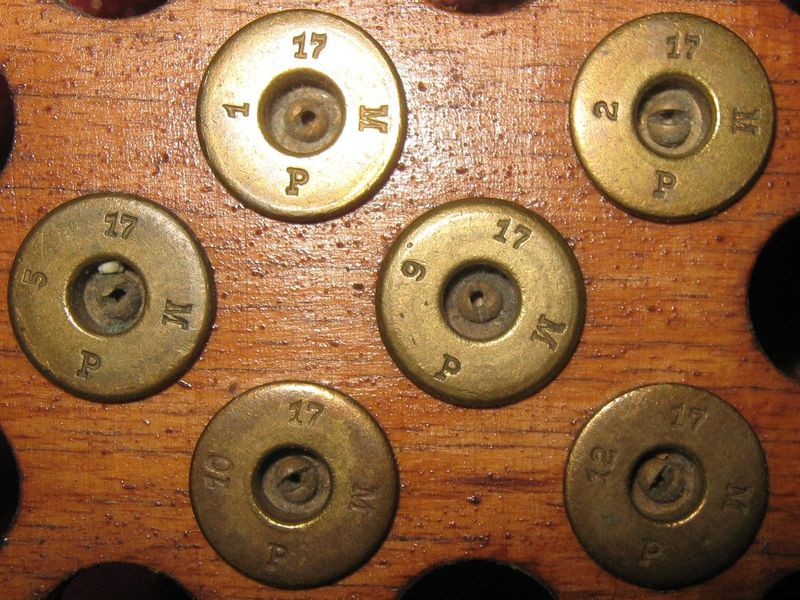

Post Re: Austrian Berdan Primers
Like this?
Polish 7,92x57 made by Zaklady Amunicyjne "Pocisk" S.A. from 1924

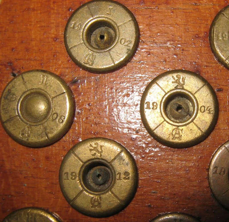

The Georg Roth Patent Berdan primer was used in ( nearly) all Austrian-made Ammo up to the late 1930s, as well as in Portugal ( to 1937) Nederlands (WW II) Romania (?WWII) Poland ( 1919-1939) and Czechoslovakia(1919-1939).
AS shown in above Photos, the Gashed Anvil with central flash hole was used in
6,5 Dutch and Romanian ( .199") 8x50R Austrian (.199") .303 ( .250") 7,9mm ( .217") 6,5 Swede ( Norway .199") 8x56R Kropatschek (.250") and several Pistol calibres made in Austria-Hungary.

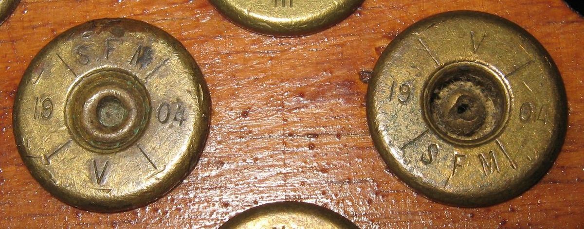

I don't know if the Bulgarian 8x50R was also Roth ( .199) primed, I suspect so, as early deliveries were from both Roth and other Austrian Factories. Deliveries from SFM were twin-flash holes ( 1904-05).
Most makers abandoned the .199" primer as they improved their manufacturing facilities, usually with German Machinery, in the middle to late 1930s.( Voluntarily or under German Occupation.) Austria began in 1930, with the introduction of the M30 (8x56R) cartridge, which from 1931 had a .217" "German" style primer ( twin flash holes). Portugal changed in 1937, when their ammo plant was re-set to make 7,9mm ammo, by RWS/DWM...they also changed the .303 Primer Pocket from Roth to Standard twin flash hole (still .250"). Portugal switched to .217" Standard Pocket in post-war .303 (by FNM)

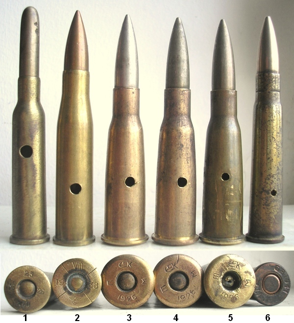

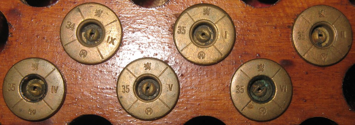

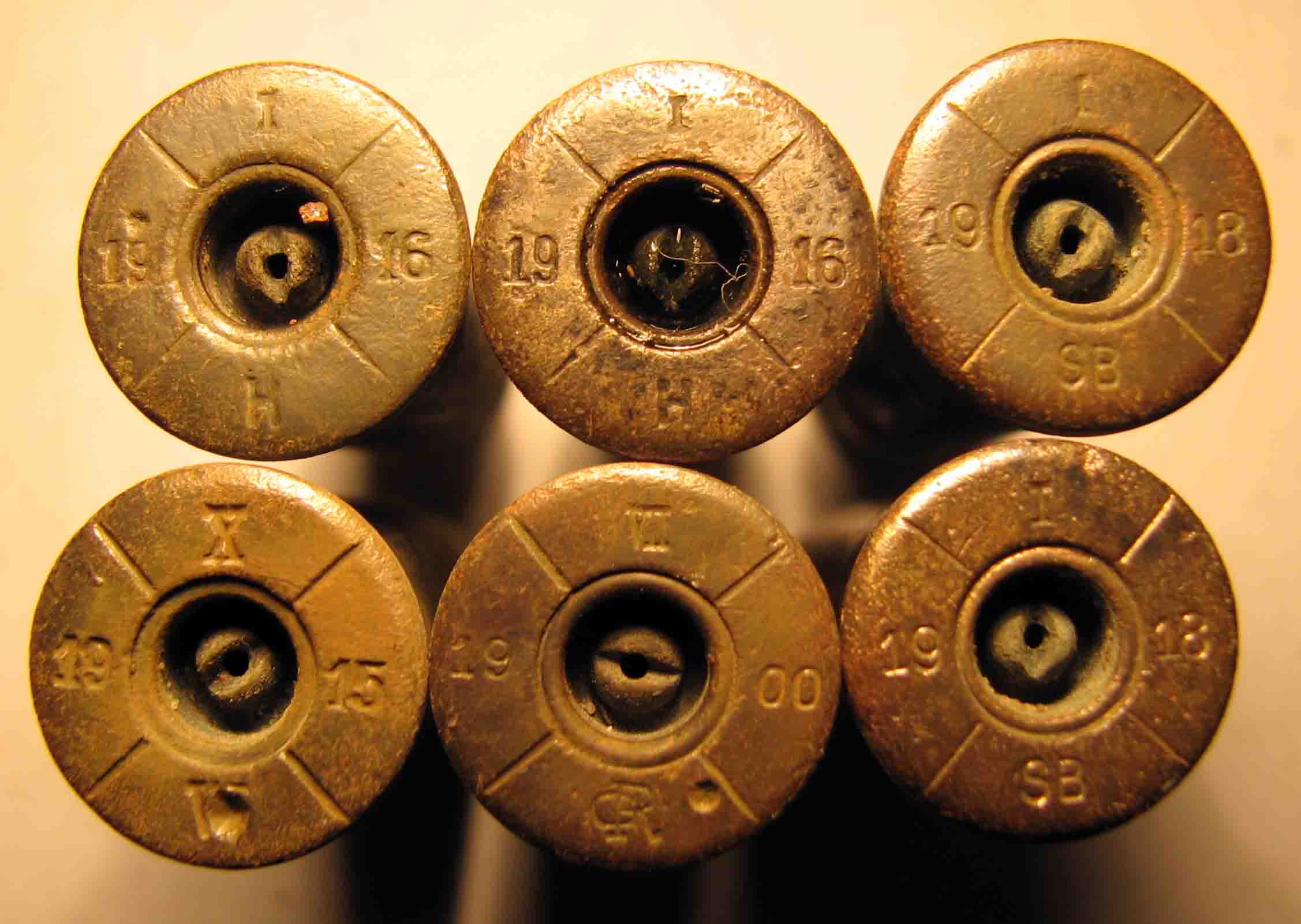

Czechoslovakian 7,92x57 Mauser. Photo by PashaM (from: reibert.info)
Greek 8x50R Lebel (no.5 on picture). Photo by treshkin (from: reibert.info)
6,5x53,5R Mannlicher. Photo by chejen (from: reibert.info)

Dear PJB,
Thanks for showing your extensive Roth primed Case collection.
The German-made 8x50R cases (during WW I) and the Romanian Contract DWM 6,5x53R M93 cases must have been made "to buyer's Specs" ( ie with Roth primer), rather than using the "off the shelf" (standard twin hole) priming method used by Germany at that time.

Nice pictures of the Austrian single flash hole primer pockets PJB. Anybody know if the "flash channel" was punched or machined? Some pictures look like they were machined or maybe just a rough die.
