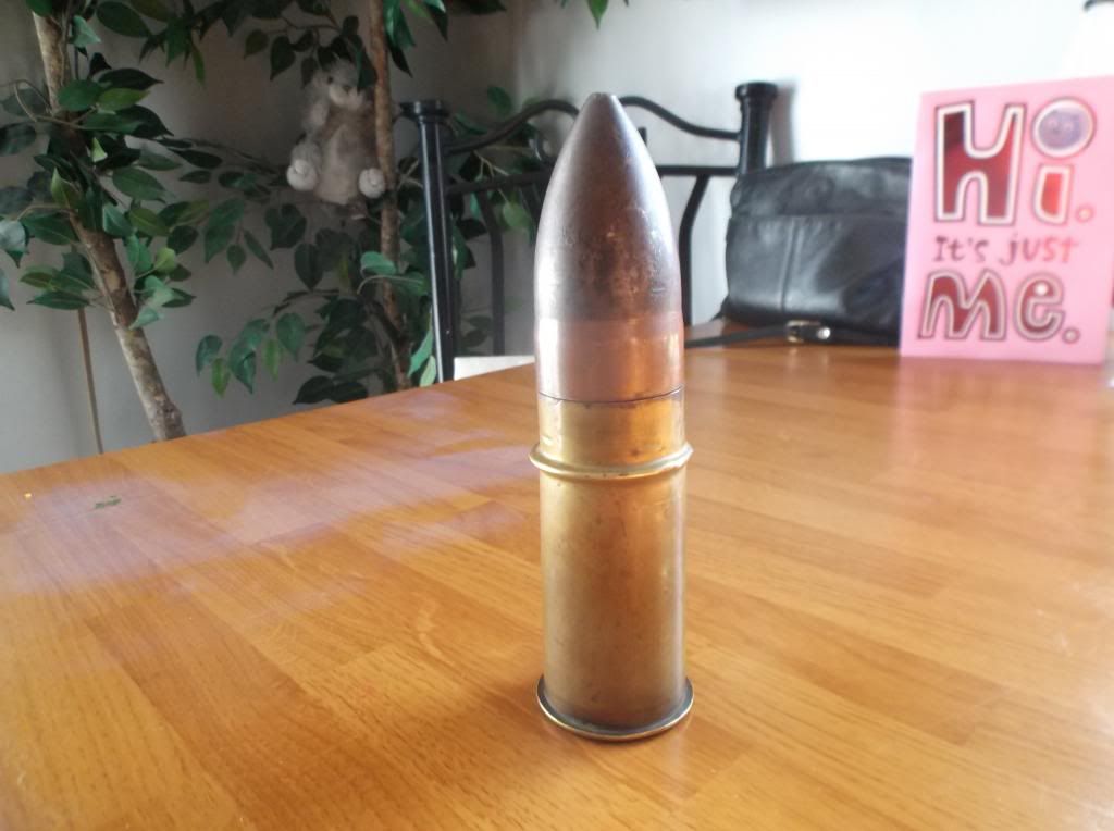

I bought this 1916 37mm shell with the casing telescoped. Iwas told that the shell is live and was wondering how this might have happened?

It may have a live primer, leading some to think that the whole thing is "live", but the powder and any charge in the shell is almost always gone. One can usually twist the projectile out and see into the empty casing. When in doubt, consult a collector familiar with these first. If an experienced collector of these is in doubt, then it is time to call in the E.O.D.

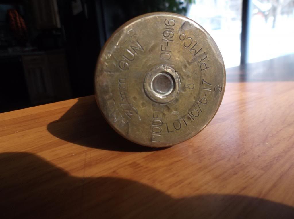

Here is a pic of the primer. I think that the bulging ring on the case was caused by reinserting the projectile.

This sort of "telescoping" damage can be caused by dropping the round onto a hard surface, base first. The shell tries to ram itself deeper into the case as the base of the case stops abruptly. The dents on the base of the case show that it has been bounced a few times.

Also, as this case is fore-shortened, there is less space inside for anything to rattle. However, twisting the shell out is the simple answer.

This 37mm round in question does not seem to be the HE type as far as I can see unless it is base fused? So not a problem, loaded or not?

The cartridge shown is a 1 Pdr Common. It is base fuzed. It can hold nearly 1/2 oz. of bursting charge, which would be black powder. The question is - does BATF&E consider black powder an "explosive"? In a grenade or artillery projectile I'm betting they would.

I was finely able to get the projectile out of the case, it was rusted in, and there was no powder. Anyone know how to get the wrinkle out of the case or should I keep it as is for a curiosity?
