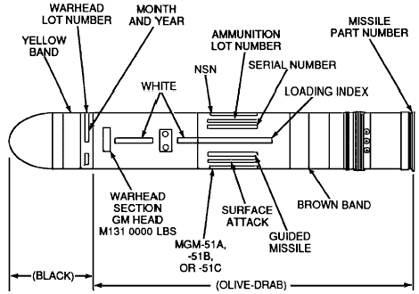

Western, would you have an image showing the complete missile?
SCIENTIA POTENTIA EST!
Mon Jun 16, 2014 3:52 pm
Joined: Sun Sep 27, 2009 10:42 am
Posts: 55
Post Re: 152mm Shillelagh guided missile
https://www.bpbsurplus.com/xcart/images/D/ds1002a.jpg
https://www.bpbsurplus.com/xcart/images/D/ds1002b.jpg
https://www.bpbsurplus.com/xcart/images/D/ds1002d.jpg
Mon Jun 16, 2014 4:03 pm
Posts: 55
and another picture complete with case.
Thank you for photos. The last picture is from a museum. Do you know which museum it is? Also, my case looks like an early stage development cartridge, but the date is 1977. What could it be? Here is a link to M551 Sheridan with photos at the very bottom http://afvdb.50megs.com/usa/m551.html
